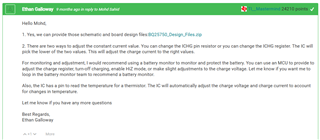

1. 캡처된 콘텐츠 중 BQ25750_Design_files의 내용을 확인하려면 어떤 도구를 사용해야 하나요?

    1. Which tool should I use to check the content of BQ25750_Design_files of captured content?
    The BQ25750 design files were created in Altium
