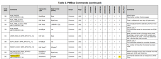

UCD90320 user's guide (SLVUAW9C) contains conflicting information on the RESEQUENCE register. Chapter10.15 it shows that the command is not supported for UCD90320:
The overview of table 2 (PMBUS commands), shows that it is actually supported on UCD90320:
Can this be cleared out?

    Thank you for pointing this out. RESEQUENCE command is not supported by the UCD90320

    I found other conflicting data in the datasheet:
    Table 2 shows that there is support for the security_bit_mask register:
    But 10.32 states that it is not supported.
    If supported by the device, can you share us the details on this register?
    If not supported, can you explain what will exactly be password protected when we enable the password protection?
  • HI
    I made a typo in my previous response. RESEQUENCE command is not support by UCD90320.
    SECURITY_BIT_MASK is also not supported by the UCD90320.
