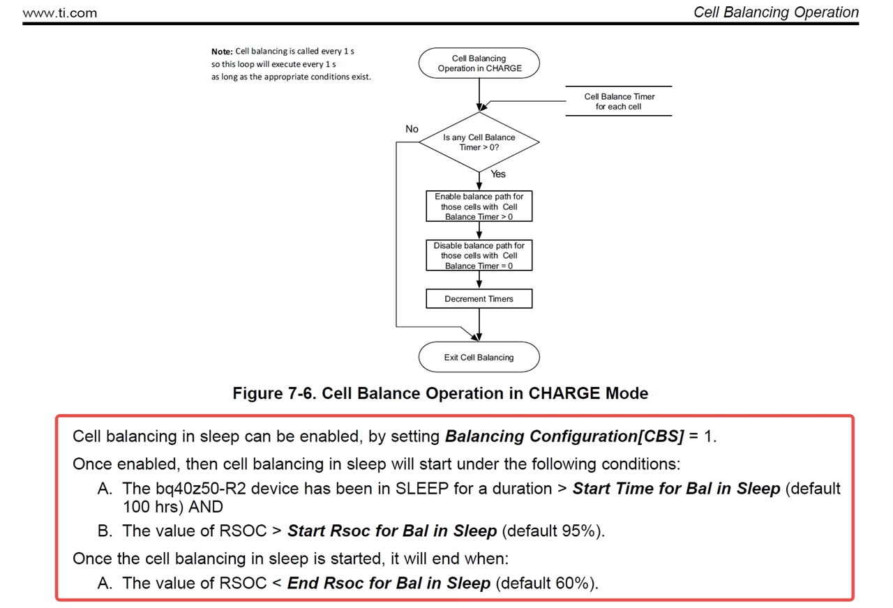

  • Hi,As shown in the red box in the following figure,
    I understand that in sleep mode, after meeting the sleep balance conditions, the battery can be balanced to the end of Rsoc for Bal in Sleep (60%). Or maybe I misunderstood, this means that the voltage difference between the cells will be balanced during the sleep process, rather than discharging the electricity to the End Rsoc for Bal in Sleep (60%) through balancing. Which understanding is correct? Or could you help me explain the operational logic of sleep balance? Thank you
  • Hi Ian,
    Sorry for the confusion, I believe your understanding is correct here. The End RSOC for Bal in Sleep here would need to be set to 60% and Start Time for Bal in Sleep should be 24 hours, however I believe we might need to change the Start RSOC for Bal in Sleep to a value slightly higher than 60%. I believe if both thresholds are 60% once the balancing has ended, there could be some sort of confusion if there is any recovery.
