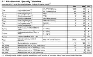

1) What is the VIN voltage should I use?
2) on the EVM board, EN0, EN1 option H is to select VIN jumper, should is connect to VLDO or V SYS in a dead battery mode and during start up?
3) The VLDO only supply around 30mA to supply TUSB321.? Do I need any diodes to isolate VLDO & TUSB321 from the main system voltage? is there any similar reference schematic available?
    Please allow me some time to review the questions.
    Depends on the device you are using, please refer to the recommended VIN in the table below
    Setting EN0 and EN1 to high is to source 3A. In dead battery mode the device is sinking power and dead battery usually means system power is not ready so tying EN0 and EN1 to VIN makes more sense.

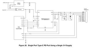

  • Thanks for the reply.
    We follow the spec. on the TPS6602x,
    So, in our case, do u means the sink path should be ENABLE during dead battery mode? or can we supply the the CC controller (TUSB321) using VBUS power instead of VLDO (diode with system voltage)?
    e.g.
    Without PD controller to control the CC pins & the TPS6602x EN the USB-C won't work properly, is that correct?
    TPS66021 is capable of CC communication (PD) but TUSB321 can only perform Rp/Rd detection specified in Type-C spec. Are these parts used on two different ports? what are the requirements of the ports?
    I don't recommend using VBUS to directly source any components as it will violate power spec in the Type-C/PD spec.
