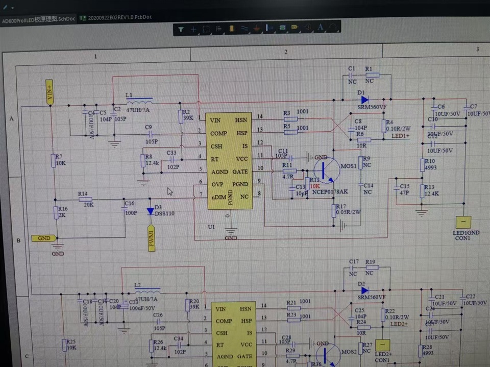

Hi TI team,
The user is encountering an EMC issue with an LM34299-based boost LED driver where electromagnetic emissions exceed limits by 5dB in the 410MHz-600MHz range when PWM dimming is at maximum brightness.Please help analyze.Thanks!
Vin=28V Vout=32V1A
