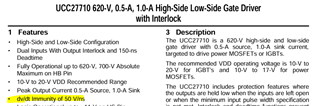

Could you please share the dv/dt immunity of the UCC27531 (Volt / nano-sec)?

We're comparing it to the UCC27710 which has a specification for this.

The UCC27710 is a half-bridge driver and the dv/dt immunity is referring to the switch node (HS). The UCC27531 is a single channel low-side driver and does not have an HS pin, so it does not have an equivalent dv/dt rating.
