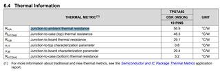

Hi team,
Could you please help to confirm which parameter should be used to estimate the temperature rising if I know the power consumption based on Vin/Vout/Iin/Iout?
BRs,
Rannie
Hi team,
BRs,
Rannie
Hi Rannie,
Typically, we will use the Junction to ambient thermal resistance.
Hannah
