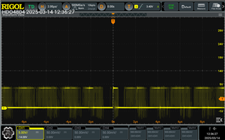

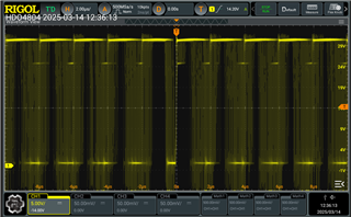

High-side FET and low-side FET behavior is strange.
Low side FET gate wave
High side FET gate wave

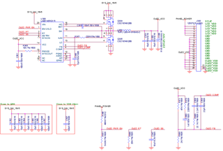

Circuit diagram
Could you please check the problem and tell me how to fix it?

HI Minsu,
Schematic looks fine to me, could you send your all layers of your PCB's layout so I can take a look at it?

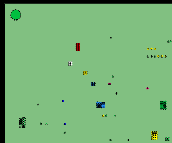

Capture and upload the PCB layout.
Layer1
Layer2
Layer3
Layer4
Please review.

Hi Minsu,
Thank you for your patience.
Looking through the layout I found some critical errors with the routing of gate drive signals. You should not have the HO/LO signals on the same board layer as SW as it can cause problems with the operation of the device. We recommend putting SW on a separate layer from HO/LO separated by a ground plane. Please review Section 11 of the datasheet which highlights layout practices that should be followed.

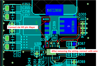

I worked as shown in the photo below, referring to the answer, but there was no improvement.
I would like to request further review.
Hi Minsu,
Both of the gate drive signals should not be on the same layer as SW, looking at the picture above, LO and SW are on the same layer. Please ensure they are not on the same layer.

I will explain the review process.
1. Cut the LO pin wiring on the PCB
2. Connected LM25145RGYR pin 13 (LO) and Low side FET Gate pin with a separate wire.
3. I connected it avoiding the SW wiring.
4. There is no improvement in operation.

I have attached a captured photo.
Hi Minsu,
Using an external wire to power the gate drive will provide much worse performance. In order to properly change the routing of the gate drive signals, there would need to be a revision in your board's layout. Please do so following above recommendations and recommendations in the datasheet.
