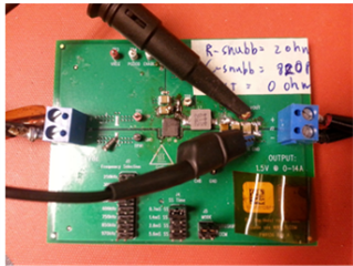

SW pin negative side absolute Max is -0.3V.
But they think SW voltage is go down less than -0.7V or more negative side until low side FET is turned on.
Is this negative pulse allowed?
Your reply would be much appreciated.
Kazuya.
  • Hi Kazuya
    If an external  voltage <-0.3V applies on SW-GND, the internal ESD diode can conduct and damage.  During normal operation, the parasitic inductance on the pcb trace and bonding wire will cause transient negative spike due to the fast switching, this is normal and should have no risk.

    They observed that the SW terminal undershoot on TPS92461 EVM was about -3V (about 20ns pulse width) .
    After that, -1V undershoot (40ns pulse width) was continued on the EVM (total negative pulse width about 60ns).
    After that, overshoot is disappeared and SW terminal voltage is stable around 0V.
    If they observed on their own board that similar level undershoot waveform of SW terminal above, is it no problem?
    Also if the observed a lower and longer undershoot on their own board, is it problem?
    Do you have any absolute max spec of negative voltage or longest pulse width of SW terminal?

  • Hi Kazuya
    Did customer measure SW voltage using smallest loop as below:
    instead of:
    The second measure method involves larger voltage spike.
    Can you please share the waveform from customer?
    Thanks and best regards.

    Yes, the customer measured the SW undershoot waveform with the method.
    Also we can share the waveform with you. But they don't want to disclose the waveform
    on this thread. So could you please give me your e-mail address because I'd like to discuss you offline?
