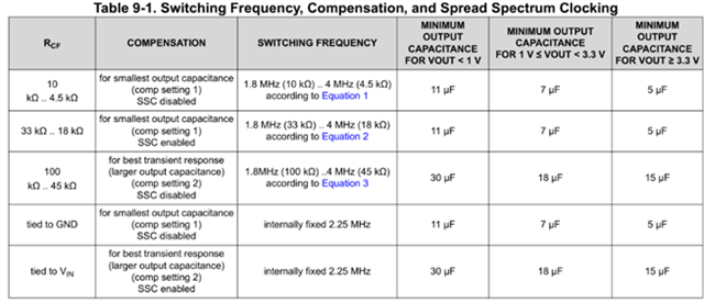

About TPS62442-Q1,
Why the comp setting 1’s output capacitance is smaller than comp setting 2?
What is the internal circuit difference between comp setting 1 and 2?
Does comp setting 2 improve transient response?
Thanks!
