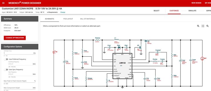

I've used Ti webench to design a SMPS with the LM5122.
Specs : Battery suply - 8-16 VDC Output 24vdc - 4 AMPS - 30 Celcius ambiant
This is not very exotic, but this is what I need to do for this project.

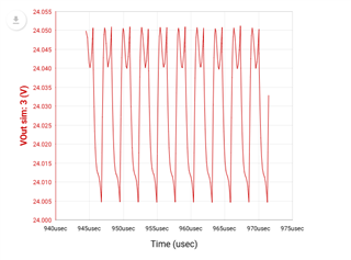

TI webench show 50mV of noise peak to peak, I did try to respect the routing note and the proposed general placement.
I'm aware that the noise can be quite different in real life vs Webench, and I am a 20 year + digital designer , but I would like an active engineer at TI to review my design.
Looks to me that a few components may be missing from this webench design.

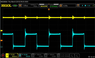

Noise on bare design is more than 3V pk-pk.
Adding a 100uF cap at the output lower that to 1V pk-pk but it is still very High. Adding more doesnt have as much effect.
Ive seen in the forum that a few person did implement the same design, and they were told to add 100ohms and 100pF on the current feedback resistor. It was quite a challenge to implement, but I did.
We didnt see any change at all.
I dont want to restart this part of the design from scratch with another part or another brand at this point, I would prefer having someone from the power management to look at it.
waveform from webench
Actual circuit with a 24V out 8ohms load (3 amps)

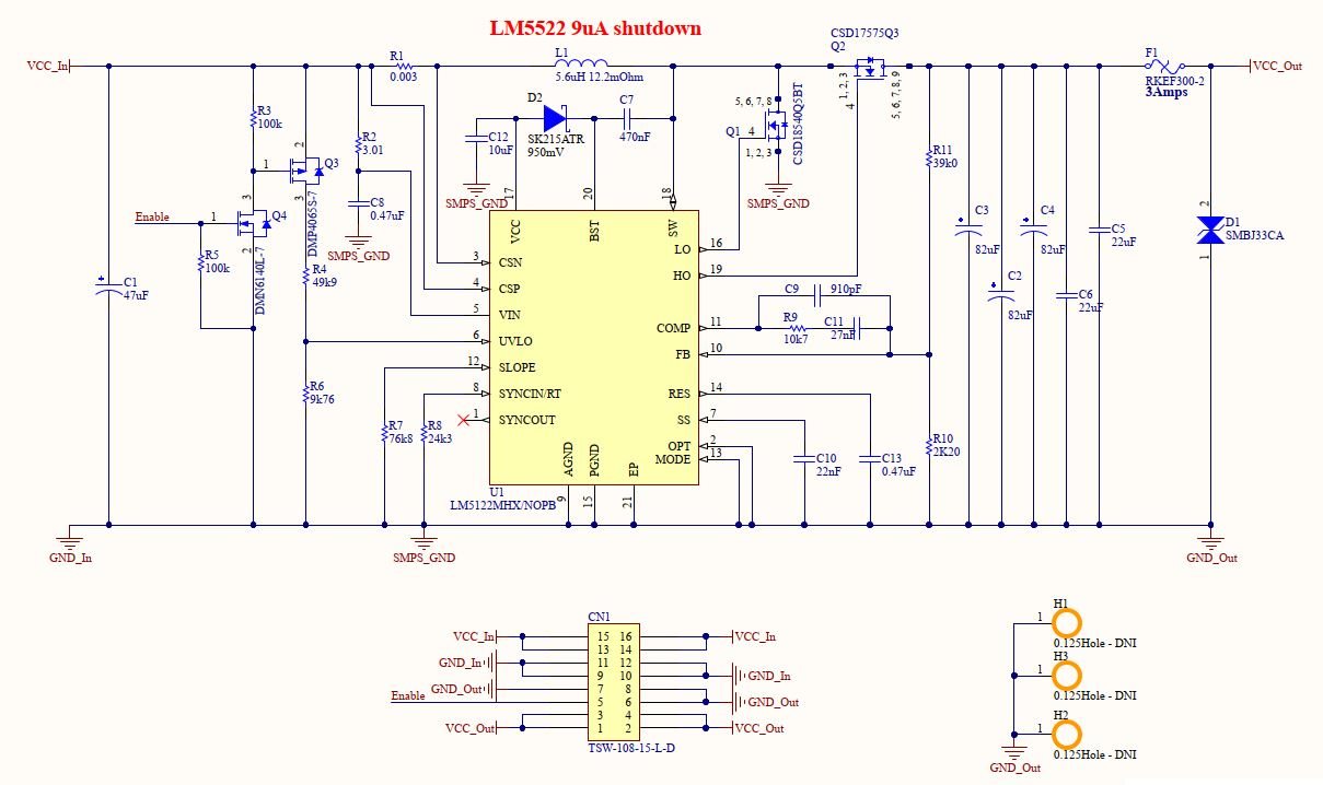

  • Hi Niklas
    Ive added the schematics to this post.
    I did some correction already:
      - I did use a P mosfet to control the LM5522. I would have take some more time analyse the circuit, I would have gone another way since the inductor and the mofset diode will let the 12V go through to the output. I did remove the R%, R3, Q4, Q3 and did a short between the pins 2 and 3 of Q3. I will control the VCC_In from the outside of the SMPS design. The noise was a little bit higher after doing that. I also implement two 100 ohms on each side of the sense resistor R1, going to CSN and CSP, with the addition of a 100pF capacitor. I did use twisted magnet wire. The effect was neglictable.
    I also see that there is some part around the HO mosfet in some design, but I have no clue about why or what value to implement.
    Q2 show some heat but still acceptable(50-60 celcius) I will improve the thermal dissipation in next version.

    How can I share my webench design with you? And is there any reason why the webench design does not recommend any of those parts around the R sense and the power mosfet?
    Thanks a lot for your help
    Daniel Pelletier
    DPe technologies
  • Hi Daniel,
    To share the webench design, you can either print the design to pdf or make a screenshot.
    The RC circuit around the HO MOSFET is a snubber. If you see large overshoots or ringing on the switch node, this snubber is meant to damp these overshoots.
    They are normally not implemented in webench, as overshoots and ringing can come from many aspects which also include layout, so it is impossible calculate suitable snubber values just based on the inputs you enter in webench.
    A common approach for snubbers is to place only the footprints in beginning and then calculate values based on the ringing behavior. A snubber calculator is also provided in the power stage designer tool.

    Before looking into schematic optimizations, can you explain once more what the waveform shows, that you shared in the initial post?
    Is this the output voltage?
    And is this just one strong oscillation pulse, or do you see this ringing at every switching cycle?
    It would be helpful if you could take a measurement that shows the switch node signal (voltage at SW) and the output voltage together in one measurement.
    Thanks and best regards,
    Niklas
  • Hi Niklas

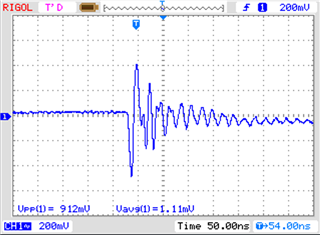

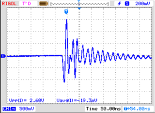

    The waveform in my initial post is the ripple from Vout, with ac coupling from my scope. This is a repetitive signal. I will post a new waveform including SW tomorrow when I will be at the lab.
    Thanks for your help

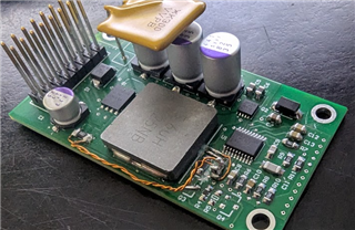

  • Hi Daniel,
    Thanks for the feedback.
    I am locking forward for the measurement.
    One additional note I can give is regarding the layout based on the board picture you sent. Q1 is on the left side of the inductor, while Q2 is on the top right side.
    This means the switch node area has to be quite long and may act like an antenna that induces a lot of noise into the system.
    Once we have the waveform picture, we might also review the layout to look for possible root causes there.

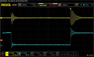

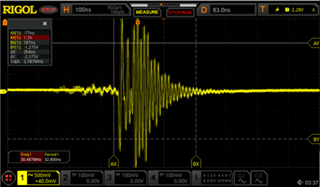

  • Hi Niklas
    Here are the recquired measurments
    Output DC coupling and SW DC coupling
    Output Acoupling and SW DC coupling
    Output Acoupling and SW DC coupling - zoom

  • Hello Daniel,
    Thanks for providing the measurements.
    The duty cycle looks stable, which is good.
    As expected you see overshoots and ringing on the switch node signal. This is also what it forwarded to the output voltage.
    This not related to the regulation compensation or current sensing.
    Here are recommendations on how to reduce the ringing and stabilize the output voltage:
    - Add gate resistance. (Unfortunately, there are no gate resistors in the current design, so this can only be added after a layout change)
    - Add RC snubber circuit around the high side MOSFET. (In the waveforms you can see at what frequency the switch node signal is ringing. You can follow the steps in the power stage designer to find suitable R and C values)
    - Increase ceramic output capacitance. (There is already C5 and C6 for this, but by adding more low-ESR ceramic caps to the output, more switching noise will be filtered at the output
    As already mentioned, the LM5122 1-phase EVM should be a good reference, also regarding possible layout optimizations.

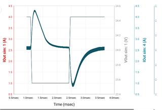

  • HI Niklas
    I did test the EVM board. The results are quite good, with low ripple on the output.
    Im still curious, so I did a few simulation with webench.
    If I use the same specs as the EV board, the design is quite similar : 10uH, close to a 1000uF on output but without the snubber on mosfet.
    If I use almost the same spec, with the only difference of 4A instead of 4.5, and leaving webench to choose the frequency, I get 5,5uH below 400uF cap on output and 370kHz freq.
    If I force the freq to 250, I get close to your EVM board. I understand that the lower the freq, the more capacitor I will have to use to filter out everything, But even with current sense filtering and snuber, my design wont work when the EVM surely works... I would have like to have another optimization option in webench called "safe design". For sure, this would be my new favorite option.

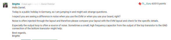

  • Hello Daniel,
    Today is a public holiday in Germany, so I am jumping in and might ask strange questions.
    I expect you are seeing a difference in noise when you use the EVM or when you use your board, right?
    Noise is often injected through the layout and therefore please compare your layout with the EVM layout and check for the specific details.
    Especially the output loop is often a source of noise. Sometimes a small, high frequency capacitor from the output of the top transistor to the GND connection of the bottom transistor might help.
    Brigitte

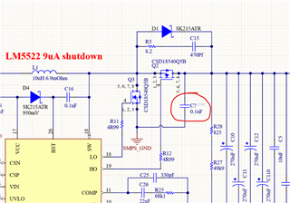

  • Hi Brigitte and Niklas
    I have routed my pcb trying to duplicate the demo board layout, within the space available for my board. I did route each sginals and plane in the same way.
    You can compare both pcb using the PDF joined in my last post.
    I also attached to this post a pdf showing the results with different load. The source was a 12V lead acid battery.
    The results shows that my design have a noise 5x to 10x higher than the demo board.
    After those tests, I've added a 0,1 uF capacitor at the postition suggested by Brigitte. The spikes are lower, but the capacitor did not affect the AC waves.
    Im open to any suggestions at this point.

  • Hi Daniel,
    Thanks for all the measurement and layout information.
    As Brigitte already mentioned, I suspect the high noise is coming from the layout.
    Within the layout files, I noticed the following:
    - The RC snubber over the high side MOSFET has a rather long trace, which reduces its effectiveness
    - Can you check if there are any vias on the GND connections of the output side bulk caps?
    I cannot see any vias in the files. If there are no vias to connect the caps to the power stage GND, they can barely provide any filtering.
    Niklas

  • Hi Niklas
    I will add a more ceramic capacitor on the output as you reccommend.
    I will also try to move the coil to the right by extending the board a little, allowing C12 to be more usefull.
    I will move the snubber over the the Q2 mosfet.
    My question was not clear about the capacitor, sorry for that. It's not the snubber capacitor.
    In her communication, Brigitte mentionned this :
    So ,I've tried with a 0,1uF 50V 0805 between Q3 Ground and Q2 output.
    What would you reccomend for that capacitor?
    Daniel Pelletier
  • Hi Daniel,
    Thanks for the clarification.
    This capacitor has the same function as the other ceramic caps at the output (C5-C8), namely to filter as much switching noise as possible.
    Due to the placement directly at the switching FETs, the filtering effect is the strongest here.
    This is also the reason why I recommended to fill this area with more capacitors in my layout comments to increase both the placement and overall capacitance.
    The lower the series resistance (ESR), the better.
    Niklas
  • Hi Niklas
    You have here the output of the proto2 without modification:
    And this is with the latest modification:
    To get there, Ive :
    - added the ground strap to simulate new vias under output capacitor
    - Added output capacitor 1x 10uF + 1x 4,7uF + 1x 1uF
    - Move the mofset snubber closer to the mosfet loop.
    To improve more, I have also removed the snuber et redone the subber evaluation process
    - Ive started my design with 8.2ohms - 470pF - believing that the value from the demo board would fit
    -Ive ended up with 1,3 ohms and 6nF
    Since I'm not mastering this part very well, I'm worried about having such values. We have a factor of 7-12x with the demo board. I'm not using the same mosfet(demo board mosfet are obsolete) The noise is lower, but I would like to have your thoughts on this.
    I will do a proto 3, and I will share the design with you before getting it out of factory.
    Thanks again!
