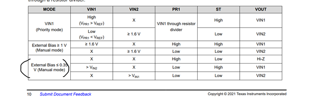

I am interested in TPS2116 to switch between 2 power sources. one of them is priority, both are 3.3v.
here is my suggestion:
if i connect in1 to PR1 via resistor divider, it will make it always the priority, and when in1 is off then it will activate in2 (provided that in2 is on).
i find a potential problem where in1 itself is not connected which means pr1 will be ground and thus mode will be 0v. datasheet says it would go into shutdown but i don't want that, i want power to always be there but one of the inputs have priority when it is alive.
i do not have any other source besides these 2 sources, thus mode pin cannot get external high input. a possible hack i found is to connect both in1 and in2 to mode pin via a diode each... therefore mode pin is always getting about 3.1v (due to schottky diode drop)... while keeping in1 connected to pr1 via resistor divider as always.
is this correct?
please check and reply in details.
