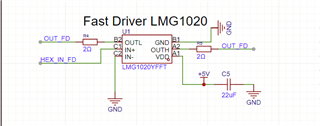

I am using the LMG1020 as a fast rise time driver, and I have attached my schematics and oscilloscope screenshots for reference. The screenshots show a measured rise time with a scope that can measure less than 300 ps.
However, I noticed that the rising edge is not perfectly sharp—there is a noticeable bend in the rising edge, which is not present in the datasheet examples. Could you help me understand why this behavior is occurring? What could be the possible reasons for this deviation? Additionally, if you have any suggestions on improving my circuit to achieve a smoother and faster rise time, similar to the datasheet specifications, I would appreciate your guidance.

    I am not driving any transistor. I am just checking the output at OUTH and OUTL, which are connected to a 2-ohm resistor that is then connected to an SMA connector. Should I remove the 2-ohm resistor, or would you recommend a different approach to improve the rising edge?

    I  connected a 2-ohm resistor to both OUTH and OUTL and then connected them together to an SMA connector. I used an SMA to BNC connector, and then the BNC cable goes to the oscilloscope. Also could you please tell me the reason for the step in the rising edge

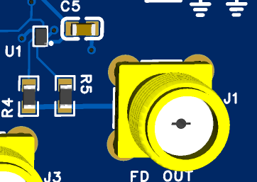

    Have you tested with 0 ohm gate resistors? can you also send a picture of the PCB layout?

    I tried using 0-ohm gate resistors and was able to reduce the rise time by 100 ps. However, the step observed during the signal's rise time remains unchanged, which is my primary concern. I’ve attached a screenshot of the layout for your reference.

    Can you try a smaller VDD bypass cap C5? The device may not be able to draw enough current quickly.
