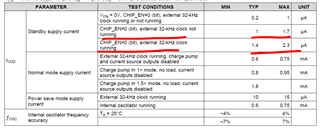

  • Hi Tyler,
    Ok, I think LP5523 (DSBGA pkg) or LP55231 (WQFN pkg) should satisfy your requirement, which supports ultra low standby current (~1uA), has animation engine control and doesn't require additional 1.8V power rail. Except for the LED common cathode connection compared to LP5569 common anode connection.
    Felix
