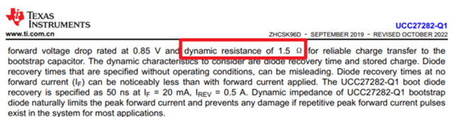

Hi Team,
Could you help to check if the 1.5ohm dynamic resistance is included in PSPICE Model? Besides, how to understand this kind of resistor?

Hi Team,

Hi Josh,
The dynamic resistance is an inherent characteristic of the diode itself and not an additional resistor in the bootstrap circuit path.
