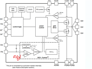

In the TPS6213x datasheet (Sec.7.5), "initial output voltage accuracy" is indicated as 800mV; however there is no actual definition of this characterictic.
In case of TPS62132RGTR (3.3V output version), does this mean that its output voltage may vary between 2.5V (=3.3-0.8) and 4.1V (=3.3+0.8),
i.e. variation from the center target voltage value?
If yes, this range seems to be relatively large if compared to a typical 3.3V system, with a typical range of +/-10%. Or possibly...  is this 800uV, instead of 800mV?
Please clarify the definition of this value, together with its quantitative confirmation.
Thank you!
    You can regard initial output voltage accuracy which indicated as 800mV as internal reference voltage accuracy.
    Colin

  • It is the internal reference voltage, not the initial voltage.
    Colin
  • I can imagine that you're very talented engineer and capable of understanding all the technical issues in the short time, but I'm not so familiar with your products. Please clarify:
    1. Clear definition of "initial voltage"
    2. Physical role of "reference voltage"
    3. What voltage range we can expect as 3.3V power supply
