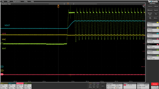

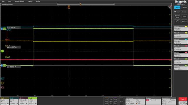

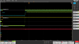

When I tried to charge the BQ25756 EVM using a battery simulator, I measured fluctuations in charging current.
Does it okay for that?
  • Battery simulator
    • Vmax : 29V
    • Vmin : 20V
    • SoC : 50%, Capa : 9Ah
  • Input supply : 23V
  • DUT : BQ25756EVM
- no load condition charging
- 1A load condition charging
Thank you.

    Thanks for working on this. The no load charging waveform looks pretty strange. It looks like a switched load is being applied.
    What model of battery simulator are you using? I think the current ripple might be coming from the battery simulator itself.
    Do you see an improvement in the charging current's behavior if you attach a 2000µF or greater capacitor onto the battery simulator's terminals?
    Ethan Galloway
  • Hello Ethan
    I used simulator 62060D-10 from CHROMA.
    Anyway, It works well after changed a real battery.
    1.5A load condition

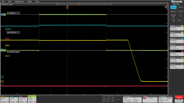

    no load condition
