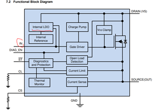

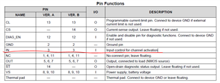

In TPS1H100-Q1 datasheet, the pin3 is for Input control for channel activation. see image below. the datasheet not shows "Input control" is internal pulldown
In functional Block diagram, it shows Input control connect to inside LDO. it seems "Input control" pull-up to high level.
it seems "Input control" pull-up to high level but not pull down to ground. That means if there is no "Input control" (floating), the TPS1H100-Q1 will switch on (VOUT= VS) automatically or default because the inside pull up make the "Input control" to high level. Is my understanding correct?
should I add external pull down resistor if I want TPS1H100-Q1 keep switch off if there is no "Input control"?
