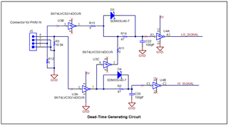

Customer would like to use clock generator output for input of LMG2100R026.
Could you guide how customer can control it for dual input(HI, LI)?

In our EVM, we use a single input to control both HI and LI signal. The single input is split and deadtime is added to avoid shoot-through.
Here is the link to EVM webpage: LMG2100EVM-097
Link to EVM user guide: LMG2100R026 EVM User Guide
In the user guide, you can view the schematic in figure 4-1. The dead time generating circuit is shown in the bottom left corner, I will paste a screenshot here:
