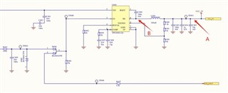

Customer reported below case:
Background:1.total 215104pcs were used, and no similar faults were found before! 2.1pcs failed samples till now.
case study:
At room temperature, TPS54061QDRBRQ1 PIN2 VCC are powered on with a 12V power supply. Point B outputs a 12V pulse waveform, as shown in the waveform of channel 1 in the above figure, and point A outputs 5V, it means it work well;
At a temperature of 80-120 ℃, when TPS54061QDRBRQ1PIN2 VCC is powered on again, the voltage at point B is 0V and point A is also 0V. After the temperature returns to room temperature, the waveform returns to normal.
Schematic is attached.
So, It seem that the environment temperature impact on the chip function& performance.
    Can you send a full image of the schematic? I think some components on the left have been cut-off.
    How is EN powered? Can you check and make sure that the EN pin voltage at the conditions you mentioned is still high?
    Also please probe the following of the failed sample vs a good sample and send the waveforms.
    1)  boot-PH (across C400)
    2) COMP voltage
