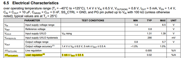

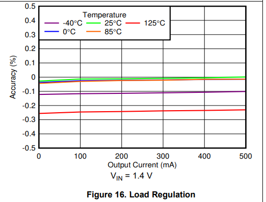

In the datasheet of the LDO I'm considering, the output current Load regulation (IOUT) is specified to range from 5 mA ≤ IOUT ≤ 0.5 A. However, The datasheet does not include a specific graph showing the regulator's performance at low load currents. but the general load regulation graph is present in the datasheet. I have attached the snapshot of that graph below along with the load regulation parameters shown in the datasheet.
