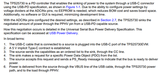

    Screenshot from the TPS25730EVM user guide
    Yes, on power up, the TPS25730 obtains configuration from the ADCINx pins. When a USB-C PD source is connected to the Type-C port, the power negotiation will happen automatically. No I2C command is used.

    ACTIVE_CONTRACT_PDO
    - In step 3 of the EVM user guide image above, a source will send a "Source Capabilities" message, which is a list of the PDOs it supports. When the TPS25730 selects one, the Source PDO is stored here
    ACTIVE_CONTRACT_RDO
    - In step 4, the TPS25730 requests one of the PDOs. The TPS25730 request contains additional information, the request data object that is sent is stored here. One significant difference is the current. The Source active contract PDO may offer more power (current) than the sink needs. The sink may request a specific PDO, but request less current than the source offers.
    To check the active contract, you need to check both the Active PDO and RDO to know what voltage and current have been negotiatied.
    The format for the PDO and RDO can be found in the USB-PD spec that is found on the USB-IF website.
