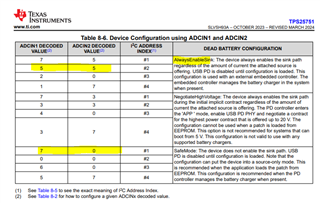

Reviewing the TPS25750EVM (schematic attached)
1. This doesn't appear to be self power over the USB-C. Is that correct? It seems you need barrel connector. I have the board on order, but, not sure if it will fit my need.
2. If it can't be self power, do you have a reference design that shows self power. This design has all the aspects I need (BQ, 12V, USB-C).
