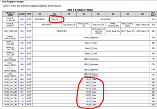

    After powering up the device, only need to write 2 registers that should turn on the LED.
    1. enable chip, write 0x40 to register 0x00;
    2. set OUTx pwm value, write the non-zero value to the OUTx_COLOR registers (from 0x0B to 0x16)
    Then the outx should turn on.
    Felix
  • that's about what I thought, although as it says "00h = The colour mixing percentage is 100%" I thought 0x00 was fully on, regardless, at 0 and 0xff there is no output, none of the LEDs light and an ammeter put between VCC and the output pin shows 0mA

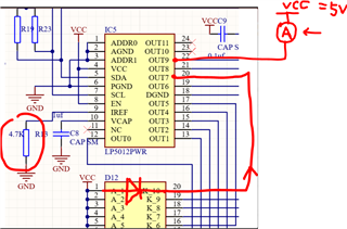

    I suppose you have connected the 4.7k resistor to the IREF, correct?
    Besides that, have you tried to read back the write value to the OUTx_COLOR register?
    Felix
  • yes. I just checked the resistor does measure as 4.7K and on the IC side its 0V when Chip_EN is off, 0.7v when its on. the diode you have drawn is where my LEDs are, I had intended to use a bar graph but don't have the part yet so I just have a bunch of regular LEDs installed.

    Have you checked the OUTx_COLOR register value after write?
    When the chip_en = 1, the OUTx_Color = non-zero value and all remaining registers value are left as default (LEDx_Brightness should also be non-zero value), there should be output current.

    From my understanding the current meter is placed between output of LP5012 and the VCC, correct?
    And you have measured the 0.7V on the IREF pin of LP5812, correct? Could you also help to measure the voltage on the VCAP pin?
    Besides that have you checked whether the OUTPUT of LP5012 is connected well to the routing on the baord?
    Felix
  • yes the meter is as you have shown, I tried both a convenient spot on the board but also a probe direct on the pin of the LP5012, in case it was a solder issue.
