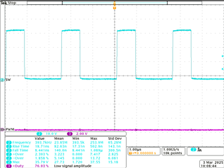

We use the LP8866S to deriver one string LED with 12LED and the hybrid dimming mode used.
below is the SW node test wave and we find the rise +fall time can not meet the datasheet right, any effect for our usage?

Hi, Mengyao
How do you do the calculation?
from wave the rise time is 18.71ns and fall time is 8.441ns, so the total is 27.151ns.
right?
Hi, Mengyao
The total Rise time and fall time needs to lower than minimum off to avoid it.
