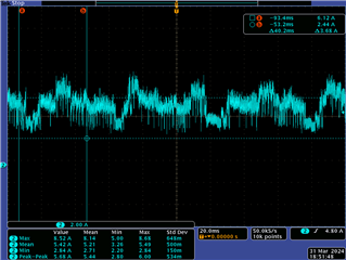

  • Hi Diang,
    Yes, the switching frequency is 250KHz.
    Normally you need try with a smaller dc-link capacitance
    => what is smaller dc-link capacitance?
    Please see the output load current below, the obvious load transient frequency is about 25Hz.
    Thanks.
  • Hi Hector,

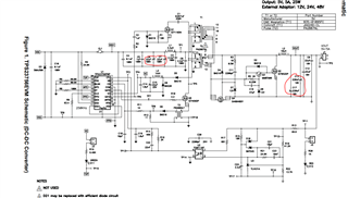

    Current ripple could be load related. And 25Hz could be related to the AC grid isolation is not good. Do you have same 25Hz ripple on the Vout?
    DC-link cap normally means the non-ceramic on the Vin and Vout bus, they have high capacitance and do not have voltage bias. Such as the two cycled cap on below TPS23756EVM (https://www.ti.com/tool/TPS23756EVM)
