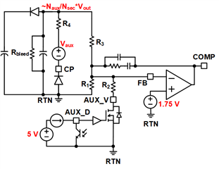

Hi Team,
How to connect the AUX_D pin when designing a flyback primary feedback circuit using TPS23755?

  • Hi Allen,
    Thanks for your patience.
    In a power oring structure, the AUX_V and AUX_D are used to lower the PoE's output voltage, to let an auxiliary power supply on the 2nd side have a higher priority than PoE.
    If you have 2nd side adapter and want to use these two pins, you can refer TPS23755EVM (https://www.ti.com/tool/TPS23755EVM-894) schematic.
    If you do not have 2nd side adapter, you can set AUX_V and AUX-D as open. And make sure the resistance at FB is updated, e.g. R190 resistance = R190 and R188 in parallel.
