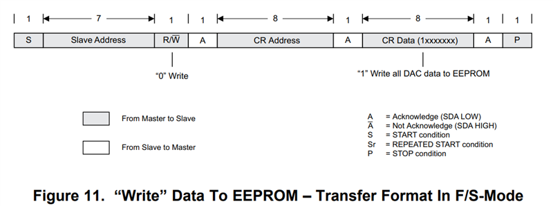

Hi Team,
My customer wants to program their setting into the EEPROM but have confused about CR register.
As the datasheet,  the CR data should be  like "1xxxxxxxx", customer did not know what exactly CR data they should write!!
Could you help to explain the whole write process and command?
