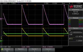

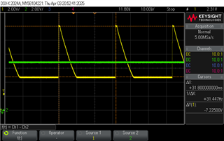

  • Helo Jeff,
    Customer responded:
    I have measured the voltage on the gate on the SHIP N mosfet and I think it doesn’t work correctly since it switches very fast. I have attached two images taken from oscilloscope.
    The Yellow line is gate, Green is voltage of the battery and the purple one is a math of these two signals.
    Is this how it is supposed the work?
    I had a battery connected with 6.82V and 15V on VBUS.
    I have this MOSFET: PXN018-30QLJ
    And I also noticed the 9.2V spike on the inductor when I connect the VBUS in.
    I didn’t connect any more capacitors to SYS.
    And I also don’t have the SYS pin connected to a system load, since i don’t want to use it.
    Archie A.
  • Hi Archie,
    In battery only mode, the 10Mohm scope probe loads the SDRV pin, which runs at 50% duty, so the above waveform is expected.  Since you are applying VBUS and still see this, then there is a problem.  You can use a DMM set to 10Gohm impedance to measure the dc voltage of SDRV in any mode.  Can you remove all power from the charger and measure the resistance from SDRV pin to ground?
    Jeff
