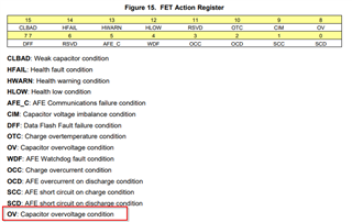

  • Jose, can you explain what you mean by "enable explicit FET action" ??
    When I refer to "enable explicit FET action," I’m talking about configuring the BQ33100 to actively control the external charge FET (
    CFET) and discharge FET (DFET) based on its internal charging and safety logic, rather than leaving their behavior undefined or reliant on default states.
    In your .gg file, under [Registers(Configuration)], there’s a parameter called FET Action.  It's set to FET Action = 0x0000This is a hexadecimal value that likely corresponds to a register (e.g., the FET Control Register or similar in the BQ33100), defining how the FETs behave under certain conditions.
    By setting FET Action , you’re telling the BQ33100 to turn off the CFET when it detects a capacitor overvoltage condition (OV). This should stop the stack voltage from rising past 9V, especially since the BQ33100 already seems to detect the overvoltage (per the SBS behavior at 9100mV).
    Note you might need to configure other registers to sync with OV such as Safety: Voltage: OV Threshold
  • Jose, so is 0x0000 the correct FET setting to stop charging? if so why will this not stop at the desired voltage? why has TI made this so difficult to use.. what is the correct write value in that register to set FET action and stop charging ?
    The FET Action register enables the charge FET to turn off when a safety condition occurs. The charge FET turns off when the a bit in the SafetyStatus register is set that corresponds to a set bit in the FET Action register.
    Please set OV bit under FET action for it to turn off the FET upon a OV safety alert.
