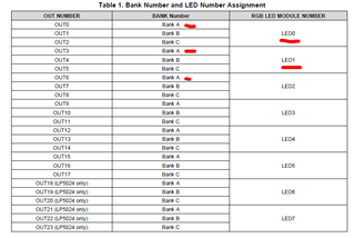

I’m planning to use the LP5024 in my design, but I would like to clarify:
Is it mandatory to connect the RGB LEDs in the specific R/G/B order described in the datasheet?
Or can I treat the LP5024 as a general-purpose 24-channel constant-current LED driver and connect any color LED to any output channel, controlling each channel individually via I2C?
Thank you!
  • Hi Tom,
    Yes, you can connect any color LED to any output channel, controlling each channel individually via I2C.
    As why datasheet shows the R/G/B in sequence, because there are additional group registers that can be used to control group channels with the mapping relationship below.
    But for your application, you just need to use the OUTx_Color registers to control each channel individually.
