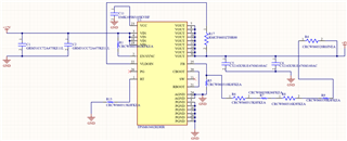

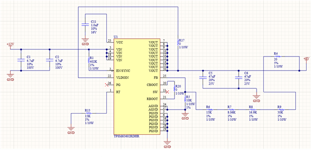

I have completed the schematic for a 12V input and 8V output configuration. I had a few points I wanted to confirm with you:
VLDOIN Pin: According to the datasheet, this pin should be connected to VOUT if the output is ≤12 V, or to GND if VOUT is >12 V. In my schematic, I've connected the VLDOIN pin to VOUT through resistor R17.
CBOOT and RBOOT: The datasheet suggests connecting these pins together for improved efficiency, which I’ve implemented in the design as well.
SW Pin: I have left the SW pin floating since the datasheet doesn’t specify anything about this, and it’s not needed in my application too.
Could you please confirm if the above points look good? I’ve also attached a screenshot of the schematic for your reference.
Looking forward to your feedback. If there is anything you feel is wrong from my schematic, kindly let me know I can do that modifications to my design.
Thank you,
Sanjana Renganatha Desigan
Pls short RBOOT and CBOOT pin with 0ohm resistor in case you may need to optimize EMI in future.
Other design looks OK!

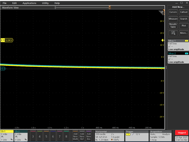

Hi Andy
One other question my teammate had — during our risetime and fall time testing with the evaluation board was, we noticed that it takes some time for the capacitor to discharge completely. We observed a residual voltage of around 1V and it goes to 0V after few seconds.
Do you have any recommendations for how we can address this in our schematic since our quantum measurements are very critical? Below is the schematic we're currently using:
Here is the screenshot my teammate gave me. It seems that we do see a very minimal voltage after the fall time. Kindly let us know what your thoughts are about this.
It can be solved by two way:
1. if the PCB design is fixed, then use much smaller feedback resistor value
2. if the layout design can be changed, then add one dummy load resistor on output to GND to discharge the Cout more quickly. you can try from 1K, and reduce it till discharge time meet your requirement.
