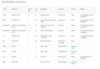

Hi Christopher,
You can find each part's reliability tests here -
For LMG3522 these are the tests that have been performed -
