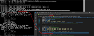

UCD90320: Error: Too many arguments when in-system-programing with csv file
Part Number: UCD90320
We encountered an issue with the I2C command having too many arguments when performing in-system programming with a CSV file.
Could you please provide a solution to fix this issue?
Additionally, can I modify the 0xEA value as shown below?
BlockWrite 0x13 0xEA
0x250000000000000000000000000000000000000000000000000000000000000000000000000032
BlockWrite 0x13 0xEA 0x2532
 UCD90320 3.0.0.3330 Address 19 SMBus Data Flash Script.csv
  • Hi
    In order to clear fault log, you can simplify the command to the following:
    0xEA0100
    EA is the command code, 01: payload length, 00: payload data. this does not include the PEC byte
    0xEA2532 is a invalid combination and you can not use it.
    Yihe
