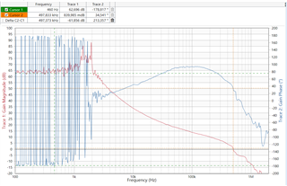

can you share advice how to make TPSM828512RDYR stable?
My customer is using the device, but with the Webench recommended implementetion, the phase margin is only 34°.

Hi Franziskus,
Can you share the schematic used? Increasing the output caps should help to reduce the cross over frequency and improve the phase margin.
