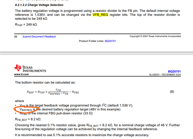

  •  The lead acid battery is 24V in my design, how should I choose the parameter VBATREG? 24V? or 28.8V?

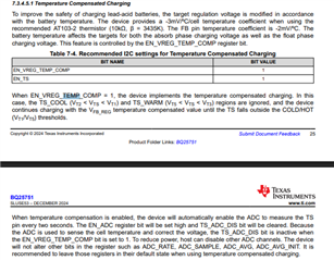

  • For TS function, without host, if the battery is too hot, could the management can close its charging function only by the hardware design? What is its reference?
    The VBATREG is the float voltage, the manufacturer of the battery is the best place to get the recommended float voltage.
    I recommend refering to section 7.3.4.5.1 Temperature Compensated charging in the datasheet:
    Christian.
    From this reference, it seems it must use register to set and enable this function. Could I use this function in hardware mode without IIC setting? If not, is there any other function to support temperature detection?
    This function is enabled by default.
    Christian.
