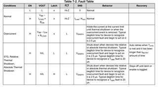

Hello Oscar,
These faults will be seen as VSNSFH on the TPS1HC100. Although overcurrent has a different behavior compared to the other FLTs reported on SNS. I have attached the FLT table.
