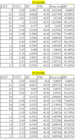

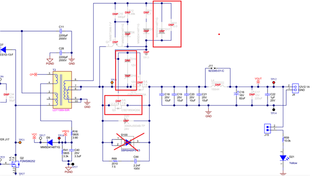

Hi, Diang,
Recently, I use PM22806 board with D100 non-installed, Q3, D18, D19, D17, R31 installed to do the test. However, I find that there is a big power loss at light load. I change the NMOS with smaller Ciss, Coss, there have about 0.8W improvement, but it still have about 2W power loss. Is there any other method to improve the power loss at light load?
Thanks.
  • Hi Ching-Fei,
    The light loss is too high, you may have a shoot through that increases the losses. I have one PMP22806 with below changes and could have an improved efficiency. Tested with 4-pairs input. Hope it can help.
    R31 = 6Ohm
    D17 mounted
    Q3 = CSD19537Q3T
    D100 DNP
    Sync FET Snubber: 100Ohm (2512) + 0.47nF
    CP pin Snubber: 50Ohm + 0.47nF
    Half-FET bridge mounted
    12V TPS23731 Test Report_Perliminay.pdf
