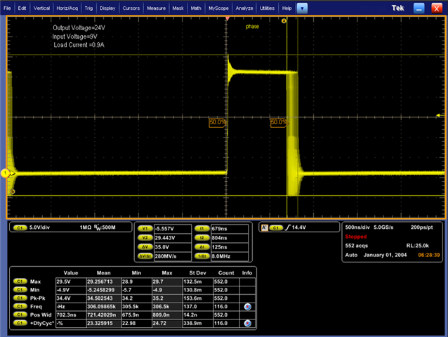

In Boost mode(Vin 9V, Vout 24V, Iout 0.9A), We measure phase node waveform as following.
Vmax 29.5V, Vmin -4.9V, Jitter 125nS,  Is this within the normal range for the LM251180-Q1, or are there any adjustments needed for schematic? Thanks.
