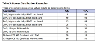

We need to have power dissipation table like of example below.

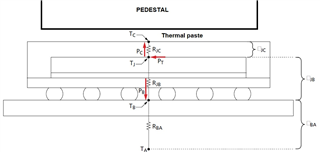

I want to calculate Tj based on the measured Tc.
Our application below.
These calculations are necessary to verify the simulation.
Could you help us?

Have you tried using the Power Efficiency Estimator Tool? (PEET) It can be configured specifically for your use case of the TPS6594133A and provide an estimate for how much the junction temperature increase.
https://dev.ti.com/gallery/info/PMIC/PMIC-Efficiency-Estimator-Tool
