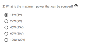

I'm using TPS25751 as a PD Source and configured four PDOs in the Web-based GUI:
  • 5V/3A, 9V/3A, 15V/3A, 20V/5A

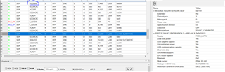

However, during PD negotiation, only 5V/3A is advertised. I’ve checked the EEPROM settings, reloaded them, and verified with a PD analyzer, but the issue persists.

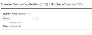

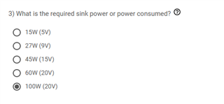

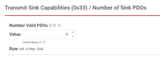

    In the Json file provided, there are 4 Sink PDOs configured and only 1 5V/3A Source PDO configured (see below)
    Source Capabilities:
    Sink Capabilities:
    Please ensure that Transmit Source Capabilities (0x32) is configured as properly in order for the TPS25751 to advertise its Sourcing Capabilities.
