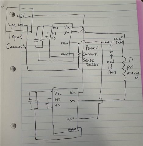

Could you help to verify Primary Current Sense Resistor connection is ok for phase shifed full bridge topology?
Hello Andrew,
Yes the connection for Primary Current Sense Resistor is fine.
You can see that the AGND and PGND are internally shorted so Please make sure that the AGND is floating and it is not connected to the Input as it can short the current sense resistor.
Also you can check this TI article on Phase- Shifted Full- Bridge Converter Fundamentals
-> https://www.ti.com/document-viewer/lit/html/SLUP414
