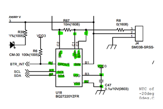

When a battery is connected to the BQ27220YZFR, this device consumes more than 100uA.
Is there a way to reduce this current?
The datasheet only specifies typ. 50uA, is this within the specifications?
The customer is using it in the schematic like the one shown below.
BQ27220YZFR_schematic.pdf
When the connection to the C1 and C3 pins is disconnected, almost no current flows, so it does not seem to be leaking to other circuits.
The host microcontroller does not start up just by connecting the battery, and commands cannot be sent to the BQ27220YZFR.
Could you please tell me if there is a way to reduce the current consumption of the BQ27220YZFR in this situation?
