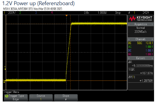

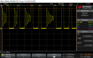

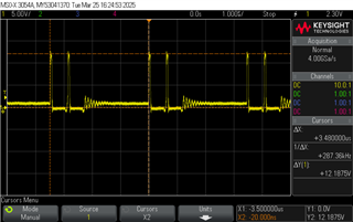

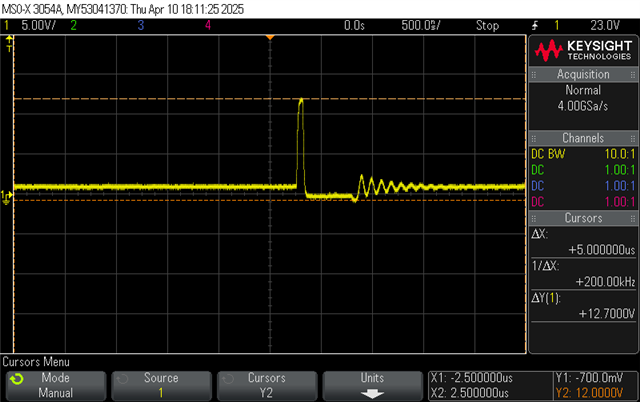

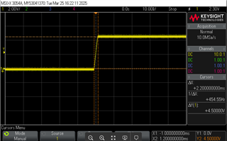

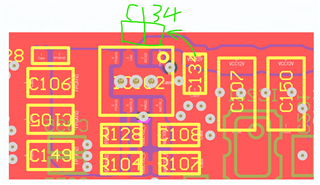

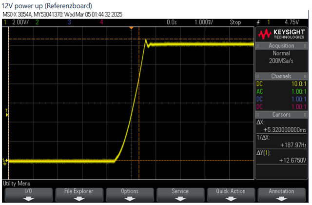

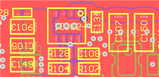

we are using the TPS82150 in one of our designs and have the issue that two parts (different productions lots of the parts and the boards) failed during operation after initially working properly. I have concerns regarding a potential design issue. Can you please review our schematics?
0160.pmic.pdf
In both cases the IC102 (FPGA1V2) failed. After replacing the defective parts the boards are working properly. The defective parts both have a short circuit (2..7 Ohm) between VOUT and GND.
Here are some measurement from a working reference board:
If you need more information, please let me know.
Thank you for your support!
