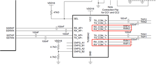

Hello. I have a question to ask. In the datasheet of TUS542, like this
RX_CON1 and RX_CON2 have no AC Coupling Capacitor. They connect to Type-C receptacle.
In Universal Serial Bus 3.2 Specification, I find that RX singles can add AC Coupling Capacitor.

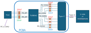

So i change my setup as below. I want to know it is correct or wrong?
Note: RX_CON add some 330nF Capacitor.
