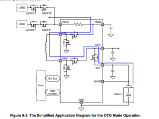

I'm looking for a 2s Li-ion charger with shipping mode , almost like MP2760  ok MP2733 (1 cell)
Do you have any advices ?
Thx
  • It's is also called Standby mode or Storage mode , where , almost no current is drawn of the battery
  • Hi Daniel,
    You may want to look at the BQ25798. It is a Buck-Boost charger with 1-4s support and an 11uA ship mode.
    Juan Ospina
  • Hello Juan ,
    Thanks for your support , but BQ25798 is a little too complexe to use , i won't need OTG or can you clarify that OTG can be totaly dislabed to avoid sourcing power at the input of the charger because i will have a DC/DC converter permanently connected here.
    This dc/dc converter will be on or off sometimes but still connected to the input of the charger
    Tell me If you have simpler parts , with ship mode that can be woke up by external pin ( even 1 cell charger )
  • Before i need to be sure that This mode (OTG)  can be disabled , because as i said above a DC/DC converter will be permently connected to VBUS and not necessary ON
  • Hi Daniel,
    For this device, OTG won't be enabled unless there is a register write to enable it (REG0x12, Bit 6, EN_OTG).
    We have multiple single-cell chargers that have an externally disabled Shipmode.
    If you are interested in a linear charger you can look at the BQ25188 or BQ25186. If you would like to integrate external rails you can look at the BQ25190. For a single-cell charger with externally disabled ship mode you can look at the BQ2562x family of devices.
