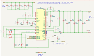

I have circuit using TPS546D24AVRFR and based on the standard workbench design. I am running into issue where TPS546D24A initializes correctly and then shuts off when a load is applied . No sure what might be wrong with the PCB or design

  • Hi Jacob,
    I recommend first checking the supply rails, specifically PVIN, AVIN, and VDD5, to ensure they are functioning properly and above their UVLO thresholds. I noticed you changed the PVIN UVLO threshold to 4.5V. When you turn on the load, there may be enough voltage drop from your 5V supply to the IC pins, potentially causing the voltage to drop below 4.5V. Please measure the voltage at the IC pins. Additionally, it would be interesting to see if changing the VIN_OFF back to 2.75V resolves the issue. Also, please confirm that there is more than 4V at the VDD5 pin.
    Another possibility is that the device might be triggering an Over Temperature (OT) fault. If the PCB isn’t designed for optimal thermal performance, it could have a higher thermal impedance.
    If you can access the STATUS bits, check which fault was triggered. This information will help narrow down the root cause.
    Thank you,
    Tomoya
    Here are the voltages across the TPS546 pins Nets. The OT fault is not being triggered because the TPS546 shuts off immediately. There is no heat to indicate over temp fault. The status error is " Status: 0x0840 "

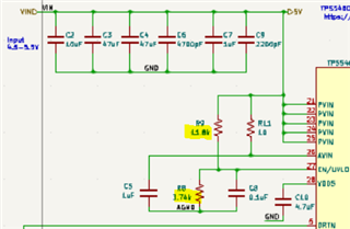

  • Hi Jacob,
    The STATUS_WORD reading shows that the converter is disabled. This might be because the EN/UVLO pin is going below its threshold. I can't clearly see the value on the schematic, but please try adjusting the EN divider to see if it helps. For a quick test, you can lower the top resistor's value or short it to check if that fixes the problem.
    Thank you,
    Tomoya

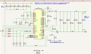

  • Resistor R9 = 11.8 K Ohms  and R8 = 3.74 K Ohms
    Above are the measurements i have taken so far around TPS546 as per the schematic below
  • Hi Jacob,
    Thank you for clarifying the value of the EN divider. The resistor divider on EN/UVLO is set to shut off at approximately 4.1V. If the PVIN is dropping out due to a sudden load at the input, it may be triggering the EN/UVLO or the VDD5 UVLO, which is around 4V.
    Could you please capture the oscilloscope waveform of PVIN-PGND at the moment the load is applied? Please take the measurement directly across the input capacitor (C6).
    Thank you,
    Tomoya

    ***** After this point , i see High IOUT Current > 12.0A in a very short time but with steady Vout = 1.145V , TRIGGERS a TPS546 Shut off ******
    I (21051) TPS546: Got Vin: 5.312 V
    I (21051) TPS546: Got Iout: 3.496 A
    I (21051) TPS546: Got Vout: 0.475 V   <====**** is this Too Low Vout during Powerup < 1.05V ? ******
    I (23051) TPS546: Got Vin: 5.359 V
    I (23051) TPS546: Got Iout: -0.292 A
    I (23051) TPS546: Got Vout: 0.021 V
    E (23061) TPS546: Status: 0x0840
    E (23061) TPS546: The voltage regulator is turned off
    It seems that the  IOUT ( OUT Current might be triggering the Shut off ) . Not sure how to resolve this
