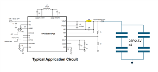

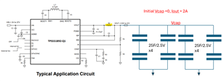

Hi TI colleague:
Could you check if TPS551892-Q1 can be used as constant current source for super cap charging? see below picture
The idea is to select R4=50mohm so the constant current can be set to 1A. Based on my understanding this should work, however I’m not 100% sure if CC mode could be continuous and not tripping the short circuit protection.
As we’re freezing our design early next week, please take this as an urgent request.
