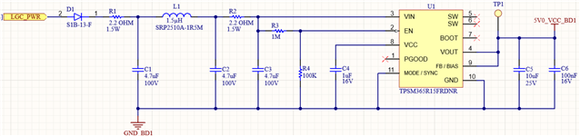

Vin = 28.0V. Expected Vout = 5.0V. Measure Vout = ~0.9V. Measure Vcc = 3.3V (which is slightly higher than datasheet). Not sure what to probe to try to determine issue since most functions internal.

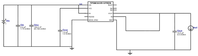

WebBench design:

What type of simulation are you running? If it is a DC simulation it may not give correct results, the models are meant for transient simulations.
