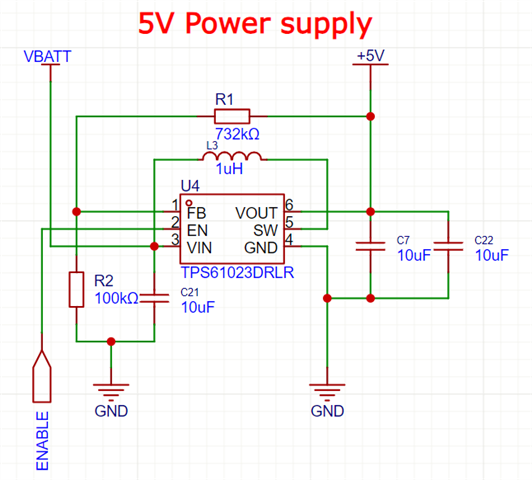

Hi, I have an existing circuit to convert 2 - 3V input to 5V output, I now wish to create 3.3V from the same 2 - 3V input.
Can I use the same cicuit but just change R1 from 732K to 453K?
Current circuit
L3 is this device
I tried the WEBENCH design helper but it gave a very small inductor with a large current, which I'm struggling to souirce through my normal channels.
Thanks for any advice
